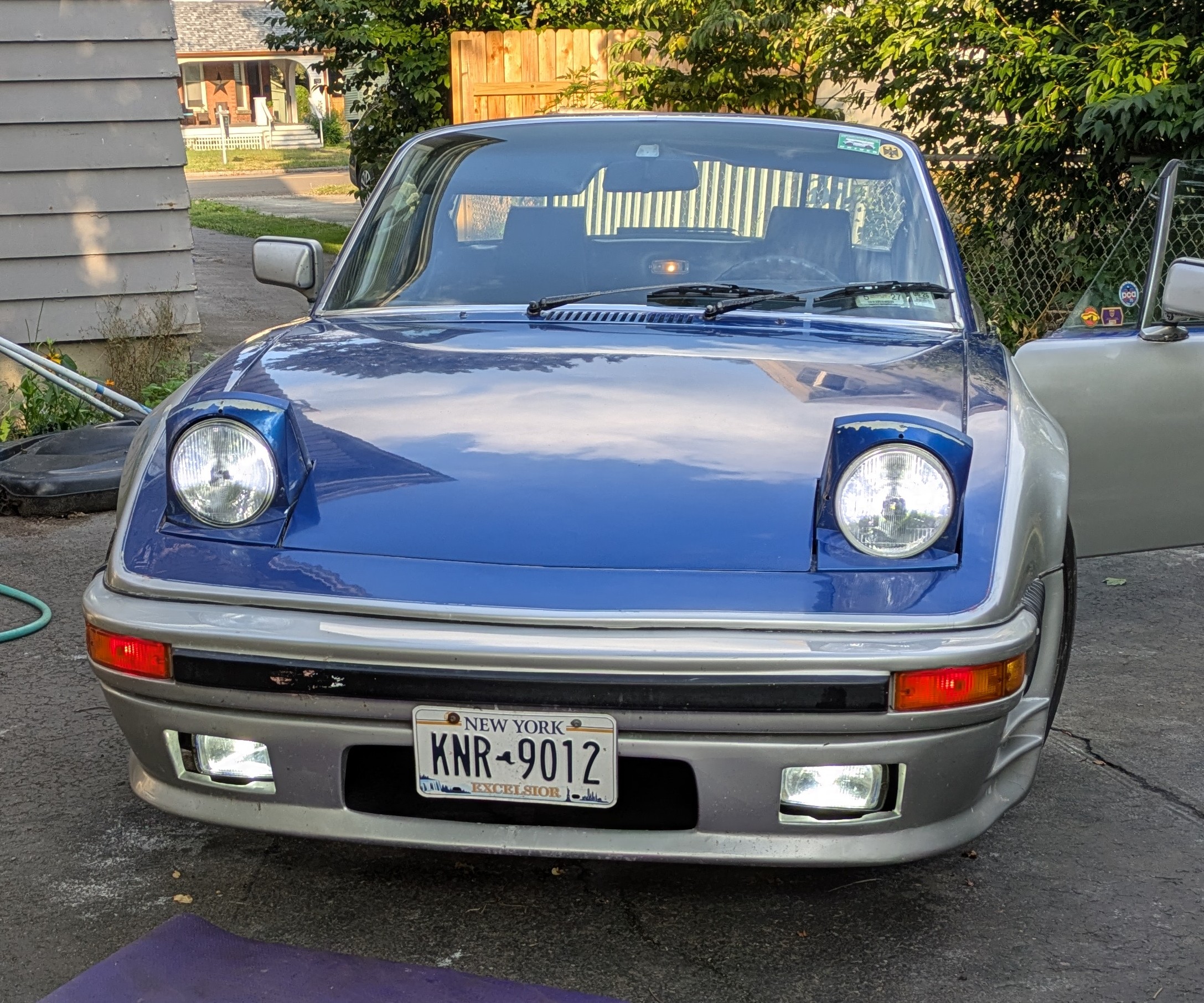

Ya' might want to hit the headlight shrouds if you have any blue paint left over...
emerygt350
post Aug 15 2025, 01:29 PM
Post #9
Advanced Member
Posts: 3,112
Joined: 20-July 21
From: Upstate, NY
Member No.: 25,740
Region Association: North East States
QUOTE(JeffBowlsby @ Aug 15 2025, 12:47 PM) *
Yes, I have been thinking about that. I didn't do the rocker covers either. Once I get a free moment I will.
